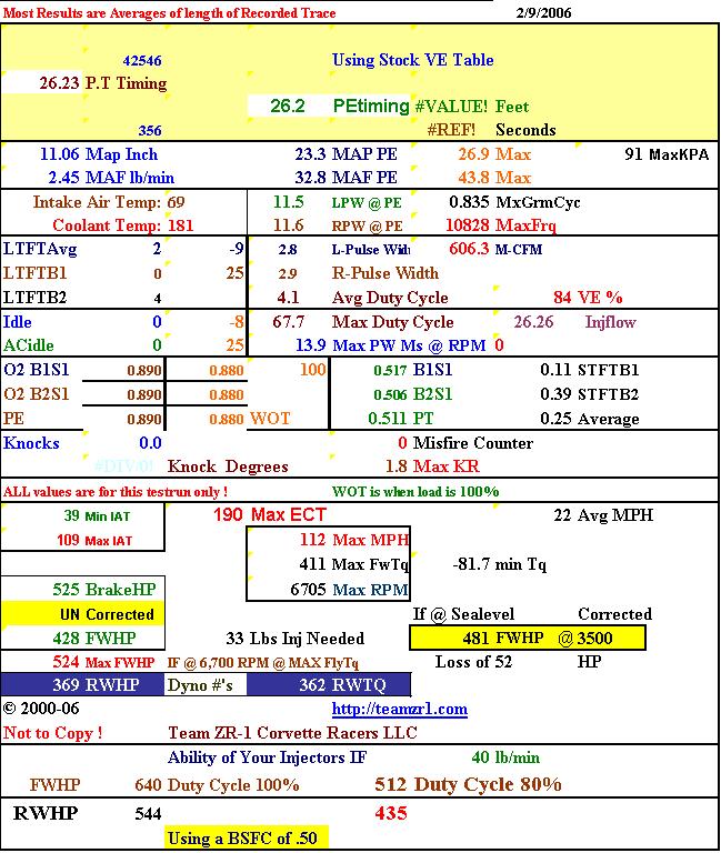

Retuning with my methods and using the STOCK VE table values a testrun proves trusting GM as to leaving the VE table alone gives the best overall functioning engine and best HP and Tq
Notice those values from past tests above when VE was screwed with
[Linked Image]
