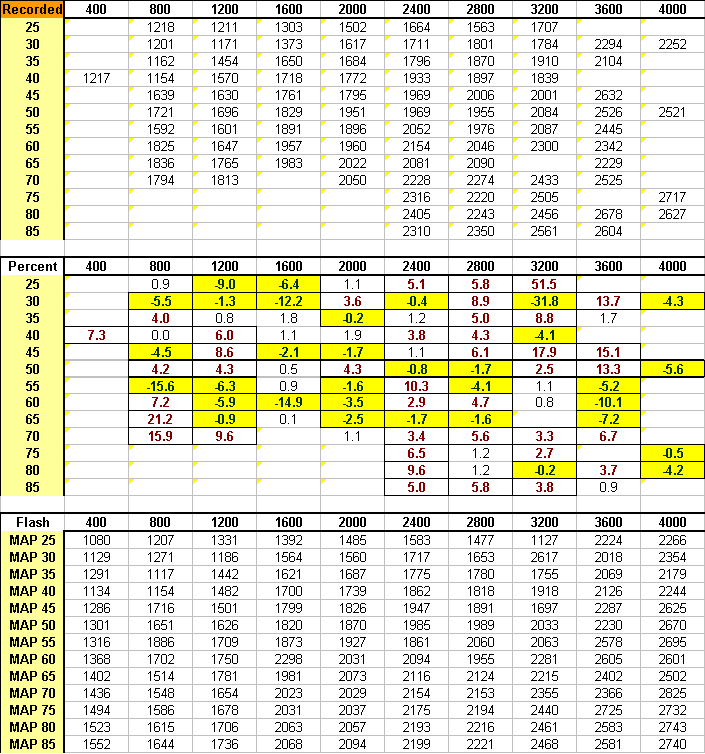

So lets do a testcase. We used our 1999 LS1 Corvette which is stroked to 372 CI ( 6.1 Liter) thus cylinder volume is different then stock, it also uses the 2001 and newer intake manifold, uses the larger 85 mm Z06 MAF, has headers and the heads are ported along with a 3rd party CAM using 40 lb/hr injectors.
Now with all those changes and the STOCK VE table values still being used you then have to assume if the HYPE of VE tuning is true then this car should run like crap.

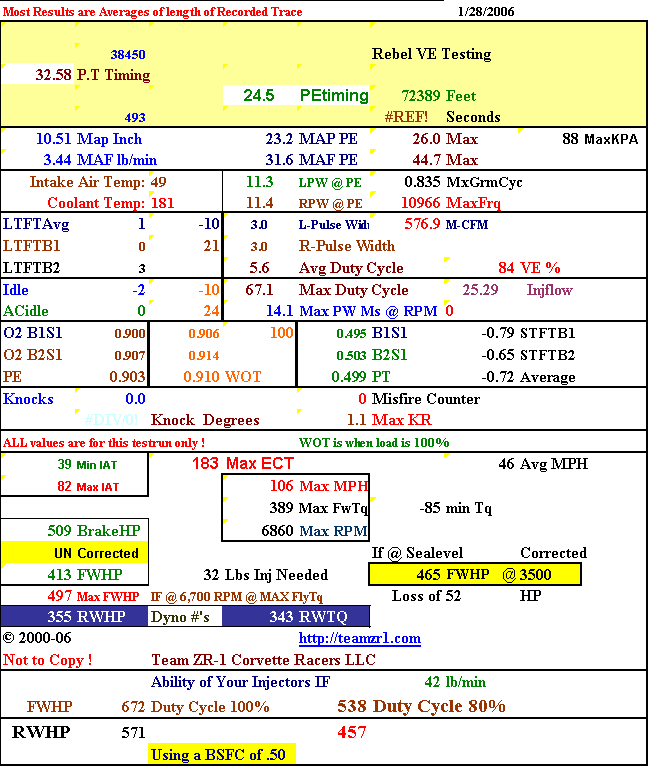

Using the Ease scanner which collects 40 frames a second of PCM data we did a daily driver test run collecting over 40,000 PCM cycles to assure we had a fair look at most engine conditions of what the airflow was versus what the statice VE table values are.
Keep in mind this was done in 40 degree winter weather, the engine compression is 11.3:1 and elevation is around 4,000 feet above sealevel ( which also would impact airmass)
This testrun collected over 33 meg bytes of PCM data !
Results :
[Linked Image]
As we see the LTFTs are perfect around zero, so are the STFTs, zero knock or misfire and O2s reporting for part throttle just under 0.500 mVolts which is just about 14.1 AFR ( recall the 4,000 feet)
Being there was almost no WOT in this testrun the corrected HP was still 465 and still saw a maximum of 45 lbs/min airflow so if the VE myth was true then this powertrain should be reporting poor performance and OBD-II values
BUT its not !

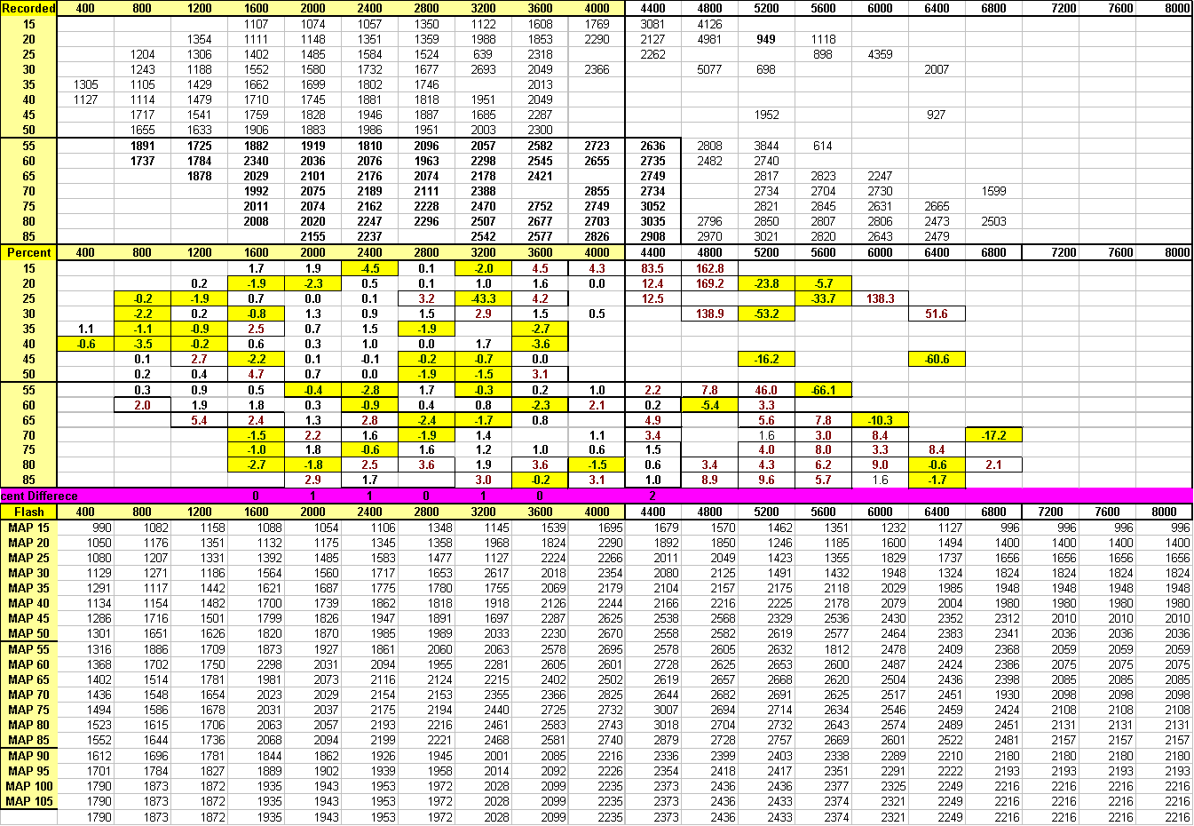

Now if we let the PCM and OBD II scanner show the facts we see below 3 tables
Bottom is the GM static VE table values
Top table is the reported air volume to cylinders and center table computes by percent the difference in what was in realworld airmass verus the stock VE values. Positive percent values is more airmass then the VE tables values and of course negative values means less air was taken into cylinders then the VE table values.
We can see in some cases a hugh percentage differences thus if in fact the VE tables were so important to engine functioning properly then the car performance and even how well if functioned overall would be quite bad, but its not because in the end its exactly what GM states that VE function is NOT used for most engine conditions and thus blowing your brains out trying to tune for a VE driven engine is a total waste of time in most cases.
[Linked Image]

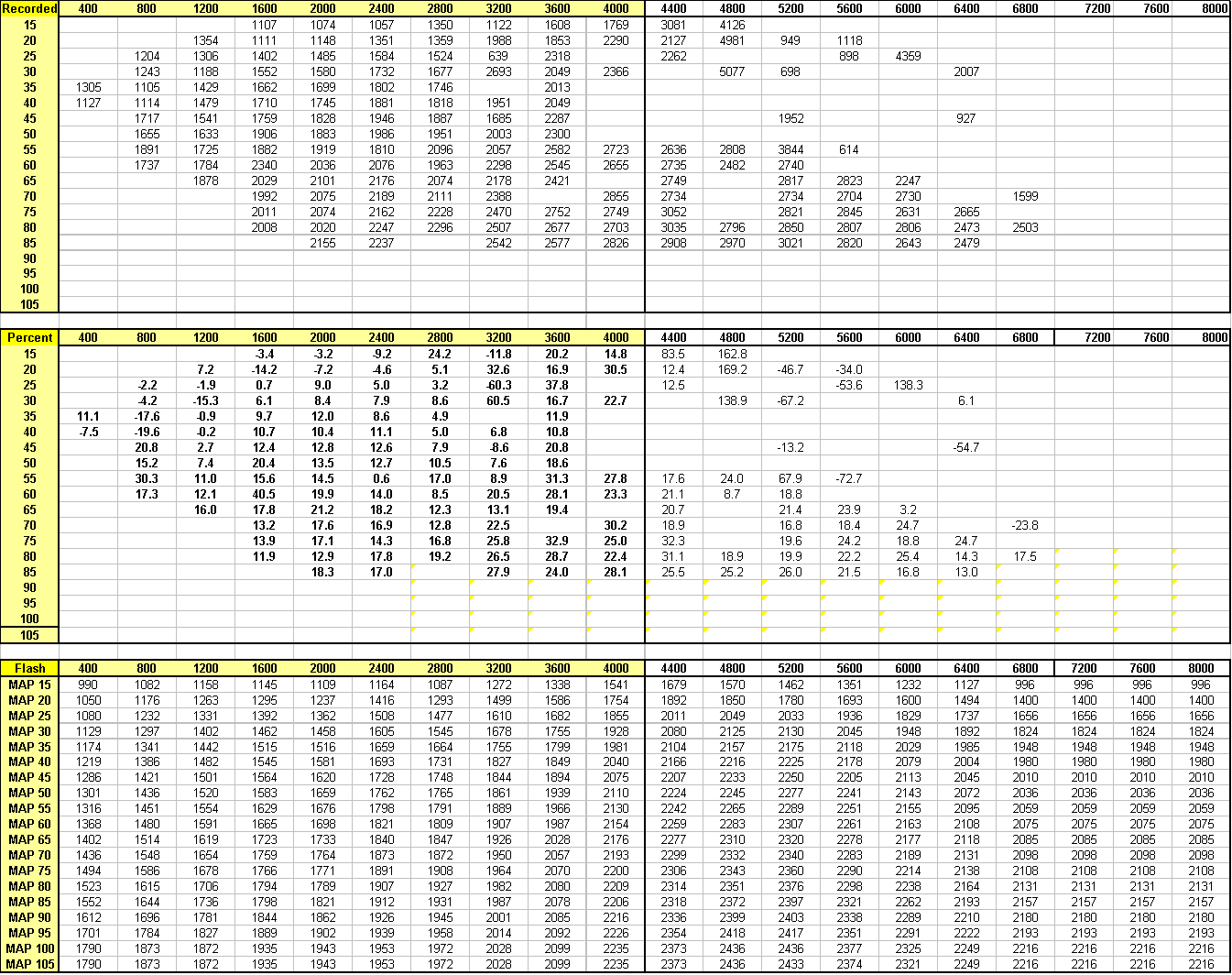

Here we found what the PCM reported was the true air volume, compared to the static VE table values, computed the difference in percent and then changed the VE table values with what the true air volume was and flashed a tune into the Rebel
The values in the pink row is the new percent difference between VE table and reported true air volume so as seen within only 2 percent difference now

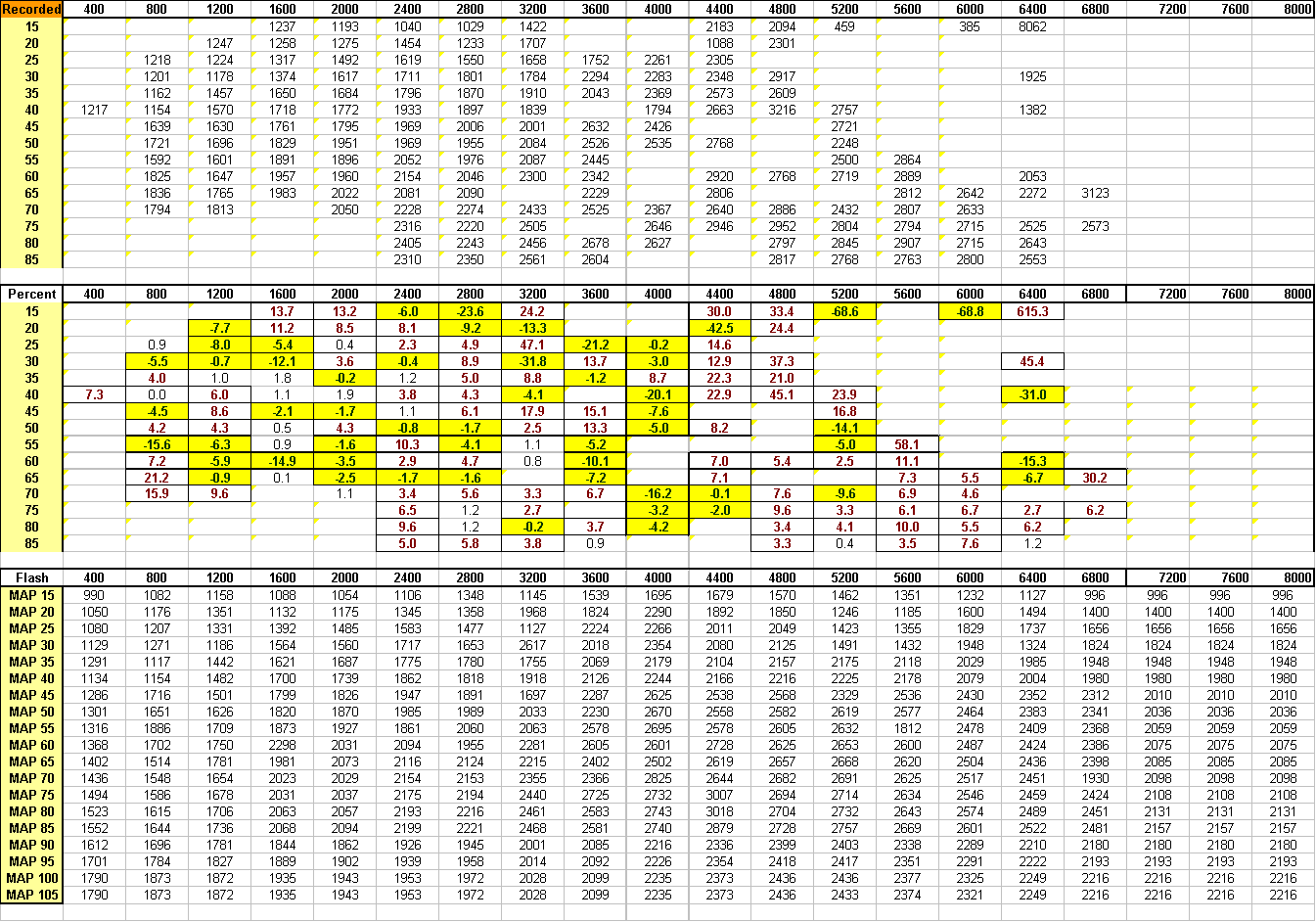

After 2 days of PCM relearn is a testrun with at least 35,000 PCM recorded cycles of data and the computed true airflow and then a difference to the new VE table values.
Keep in mind values below 25 KPA MAP are from lifting on gas pedal thus PCM is reducing or turning off injector flow and that the PCM will not even use the VE tables above 4,000 RPMs

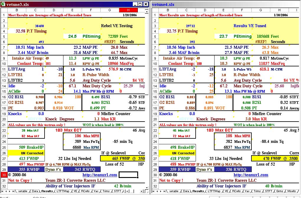

Here we have a compare of before and after the VE table values were changed within a PCM tune.
As we thought there is ZERO difference in performance, part throttle or idle conditions
We did feel (as expected) some surging during decel.
Both testruns were using same road, same weather, same drivestyle and end results is :
TOTAL waste of time, this again proves the PCM does just fine adjusting to all these engine changes and using the MAF to proper function with those engine mods.

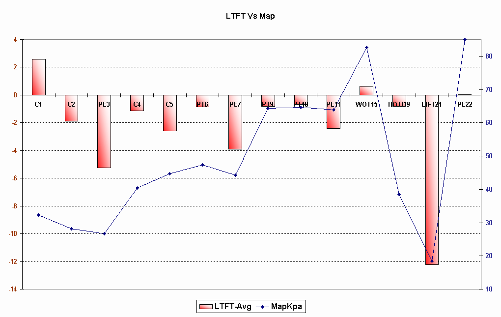

[Linked Image]
If we compare the fuel trims and MAP before VE tuned we see what should be. cells 1 and 21 are decels and should be lean because PCM to conserve fuel will reduce injector flow while there still is airflow
[Linked Image]

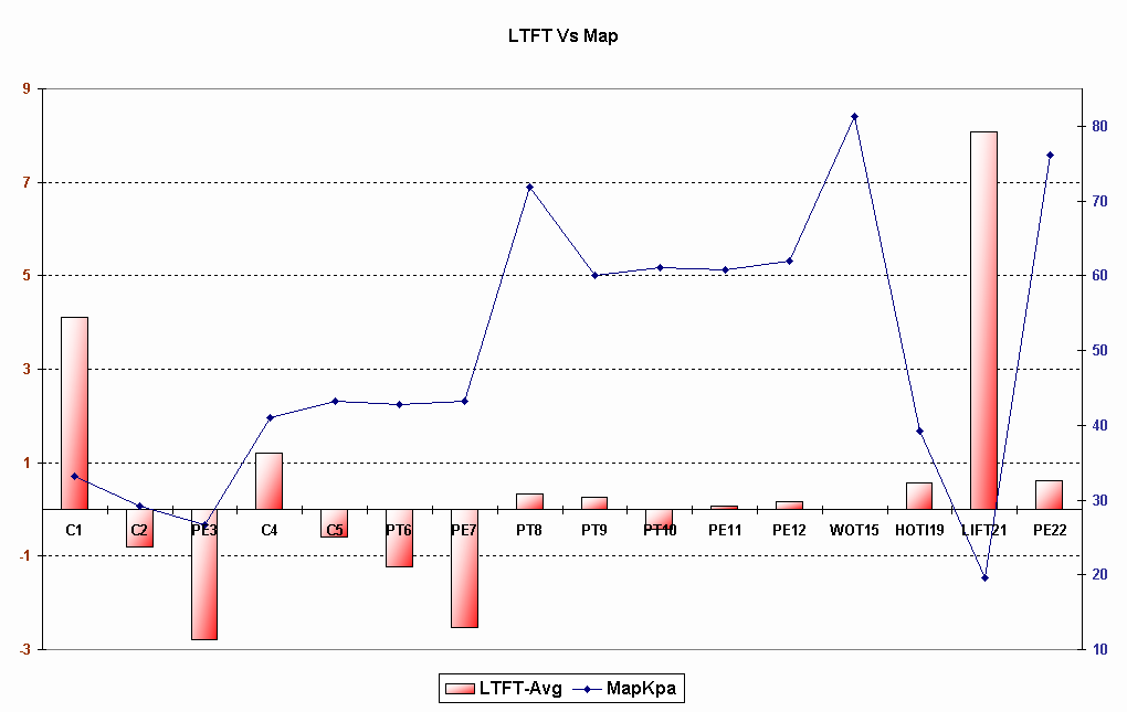

Now look what happens when matching VE table values to the real airflow and now we see cell 21 is super rich when it should be lean
[Linked Image]
In all testcases VE tuned was a negative and trusting PCM to make use of the MAF is the best path for good running and performing powertrain
