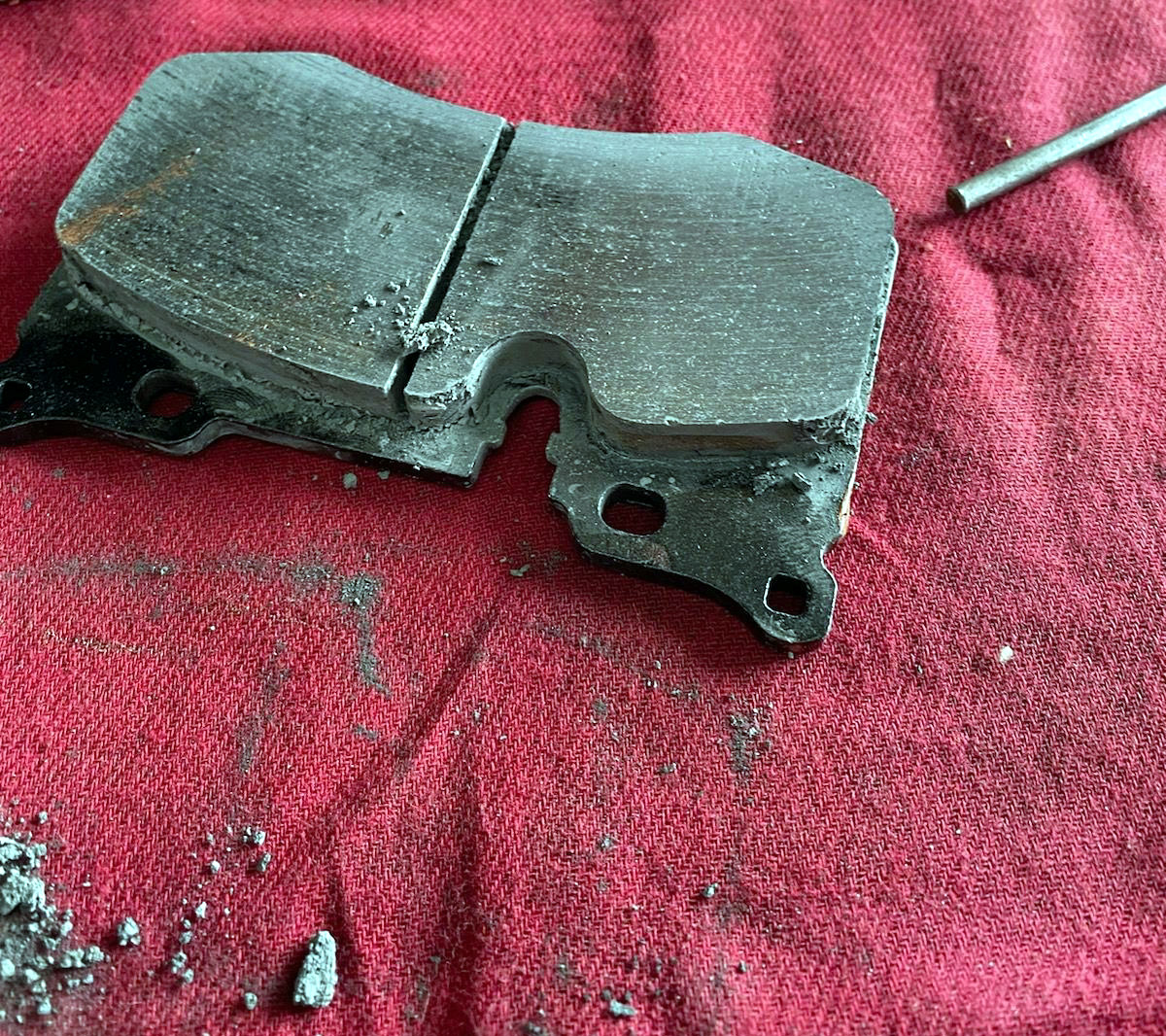

I refused delivery of my 2024 Corvette, mechanical problems.
VIN # 1064.
My car was built on September 27, 2023. It was delivered on October 8, 2023. I went to pick it up on October 16, 2023.
I had an agreement with the purchasing dealer that when my corvette was unloaded from the transport truck that it gets parked and is not touched until I arrive. On Monday morning, my salesman and I removed the transport cover from the car, and we did a very good inspection. Everything looked good as I expected, no damage.
After our inspection, we put the car in gear to drive it over to the service department for the PDI work. As soon as we started moving, the car started making all kinds of loud noises. We looked at each other with disbelief. We were wondering if we should even move the car around to the front of the dealership. The car was shuddering when we moved it. It seemed like every brake was catching and releasing. The car has 2 miles on the odometer. The distance to the front of the dealership was maybe 700 feet.
We were met by the Sales Manage and the Service Technician in the front of the dealership. The technician said we need to pull the car into the service bay and put in on the lift. As we drove the car to the service bay, the car was dragging and shuttering and pulling from side to side. He put the car on the lift and removed the rear two wheels.
To our surprise there was a lot of gray substance material which looked like graphite all over the brakes, rotors, and the wheels. All four wheels had the same substance on them. The tech removed the brake pads from the driver side rear caliper. The pads were full of this gray substance. The technician’s comment was he had never seen anything like this in all the years he's been working on new corvettes. We also suspect an axle problem.
The technician sent pictures to GM tech support and was told they had no idea what the substance was. This car should have never left the plant because the noise and driving ability was obvious.
Unfortunately, I refused delivery of the car because of the issues.
