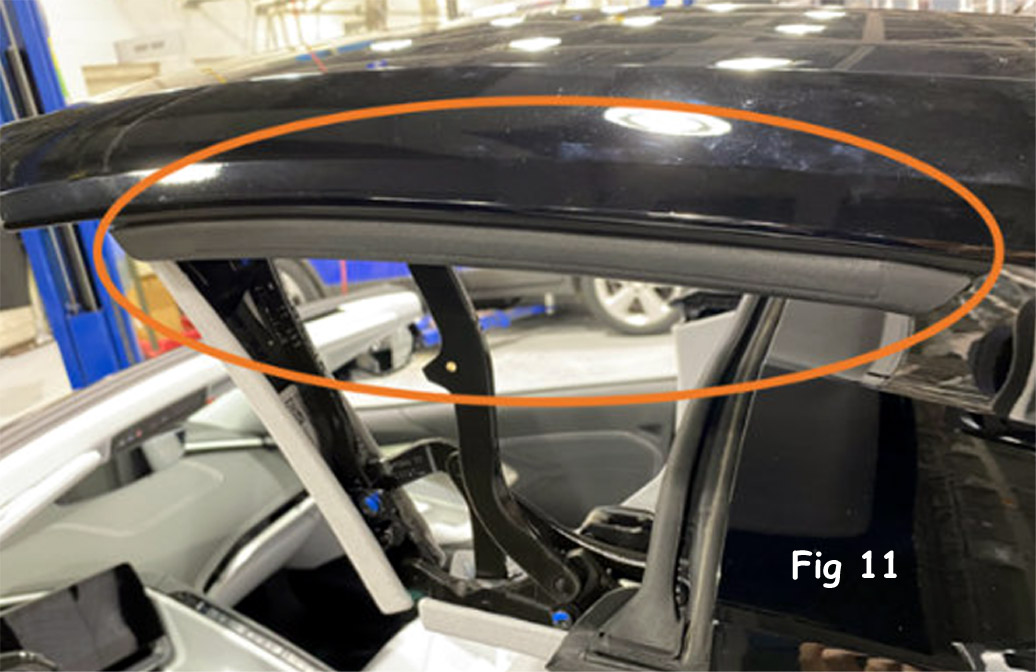

Some 2020-2024 Corvette convertible models may have a water leak around the side glass. The leak, which is found at approximately the middle rear of the side glass area (Fig. 11), may be noticed when the vehicle is exposed to a high-pressure car wash. The side glass leak may be due to slight variations in sealing between the roof panel seals. To correct this condition, a piece of semi-closed EPDM foam should be installed at the edge of the top panel.

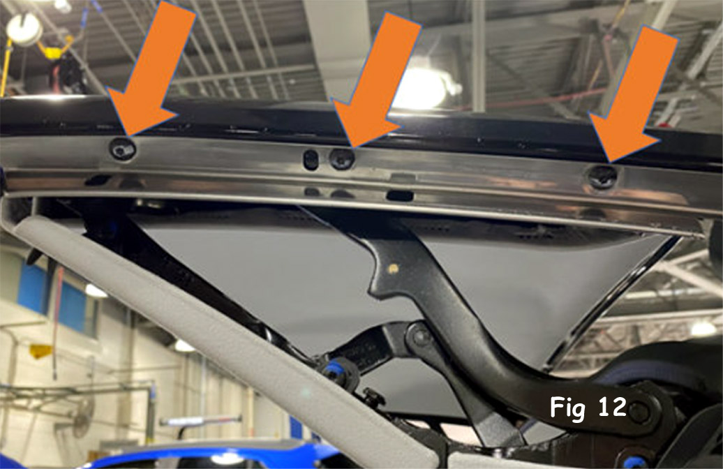

Partially retract the top to access both ends of the top panel and remove the front-side window weatherstrip as well as the three T-25 bolts securing the front-side window weatherstrip retainer. (Fig. 12)

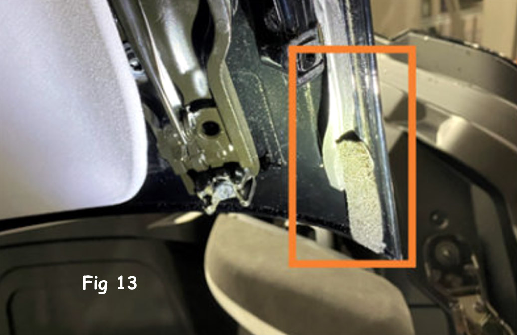

nstall a piece of semi-closed EPDM foam just inward of the rolled outboard edge of the top, but not on the edge itself so that the foam is less visible when the top is closed. Place the foam’s narrow edge just forward of the trailing edge of the top panel. (Fig. 13) Reposition the existing narrow foam strip slightly inboard to accommodate the size of the added foam.

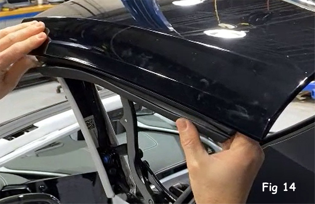

After installing the foam, reinstall the front-side window weatherstrip retainer. The retainer should cover a portion of the new foam piece to help retain it. Next, reinstall the weatherstrip. Weatherstrip installation is sensitive to position, so be sure to properly install the weatherstrip to prevent any additional leaks. Refer to Bulletin #24-NA-026 for a helpful video showing correct weatherstrip installation. (Fig. 14)
