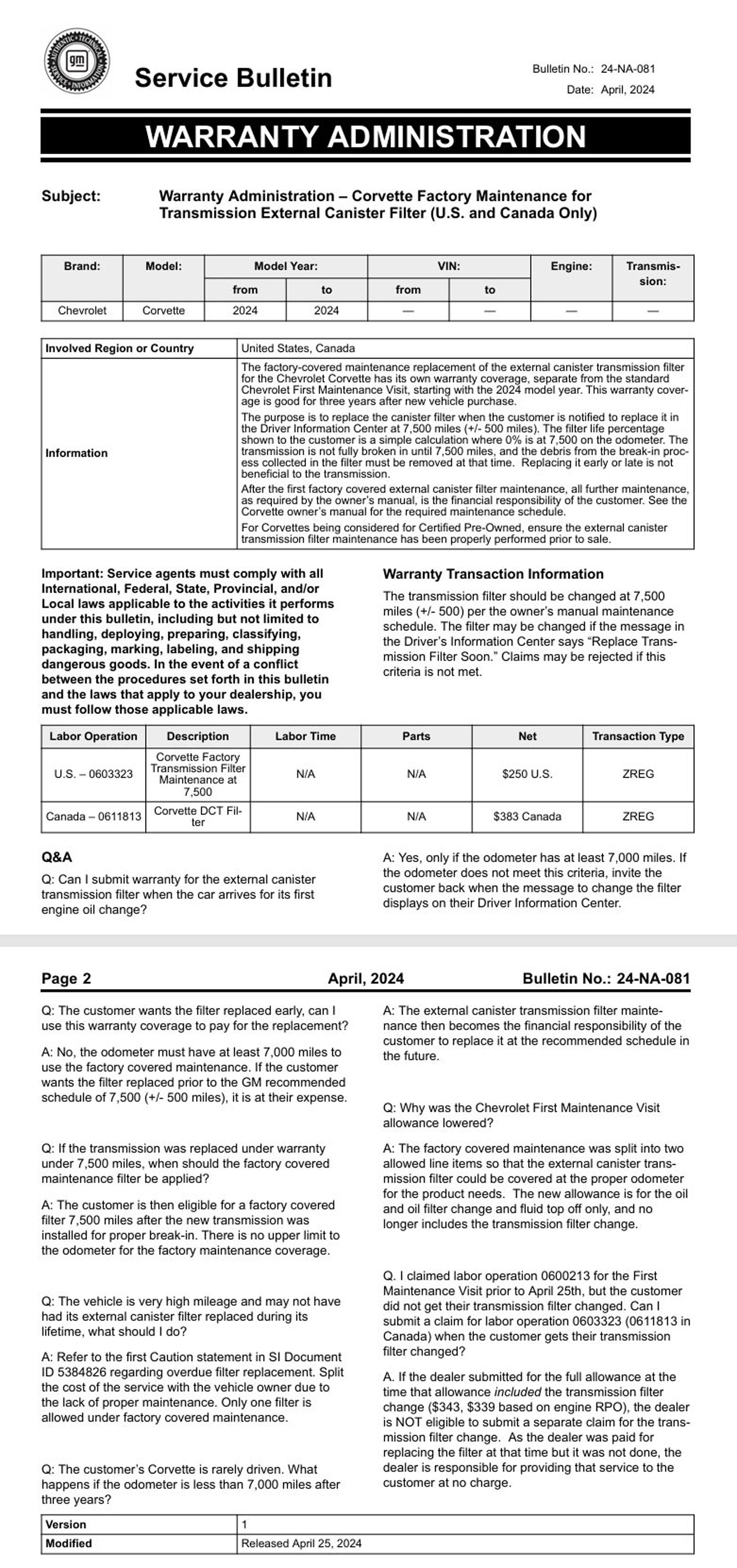

Also, part of the confusion stemming from the C8’s transmission service is the question of who pays for it, as GM initially promised to cover that during a “First Maintenance Visit.”
However, many were finding they only met the time requirement for a motor oil change, but not the mileage requirement for the transmission filter change.
For 2024+ Corvettes, the motor oil change and the transmission oil filter change are now split into two separate warranty items.
Earlier in April 2024, GMs issued Service Bulletin no 24-NA-081 that details the Warranty Administration of the C8 Corvette’s Transmission Oil Filter Canister for 2024+ Corvettes and there is a perfect Question and Answer section that goes along with it.
• If you want to replace the Transmission Oil Filter prior to 7,000 miles, you can, but at your own expense.
• If it takes you more than three years to reach the 7,000 miles, the replacement of the transmission filter becomes the financial responsibility of the owner.
• If the Vehicle shows high mileage and the transmission filter has never been replaced, the cost of replacement may be split between GM and Owner.
