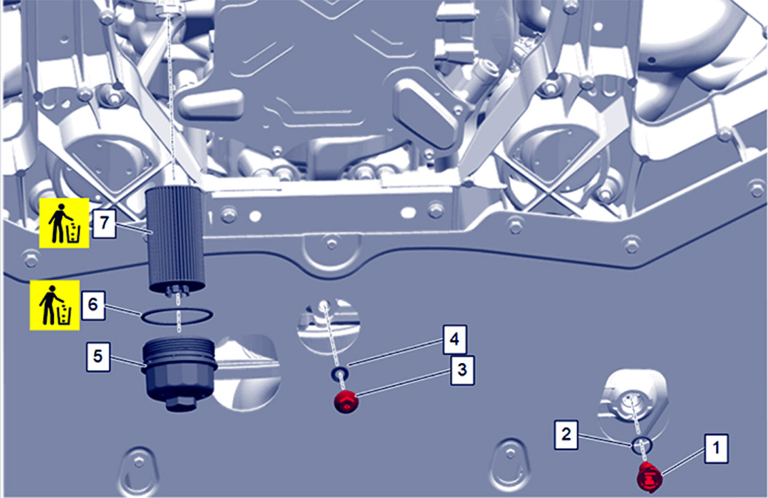

When changing the engine oil on the 2023-2025 Corvette Z06 equipped with the 5.5L V8 engine (RPO LT6), it is critical to follow all steps in the Engine Oil and Oil Filter Element Replacement procedure in appropriate Service Information.
The 5.5L engine (RPO LT6) oil change procedure is different from the 6.2L engine (RPO LT2), which has just one drain plug. The 5.5L engine has two oil drain plugs that must be removed during the oil change procedure. There is a drain plug for the lower oil pan (Fig. 12, #3) and a drain plug at the oil tank location. (Fig. 12, #1) Allow the oil to drain completely from both drain plug locations.
If one of the drain plugs is not removed during the oil change, allowing all oil to drain, adding new oil can overfill the engine, leading to potential drivability and/or engine damage concerns.

When changing engine oil and filter:
Run the engine at idle for about 20 seconds to return all the oil back into the dry sump oil tank. Turn the engine off prior to draining the oil and remove the oil fill cap so the oil tank can breathe while its draining. Drain the oil within 10 minutes of engine shutdown. Remove the drain plug from the bottom of the external engine oil tank, followed by removing the drain plug from the bottom of the engine crankcase (oil pan). Release the oil pan drain plug by pushing upward while turning 1/4 turn counterclockwise. Replace any damaged drain plug O-ring seals. Install the engine oil filter cap with a new engine oil filter cap seal ring and the new oil filter element.
