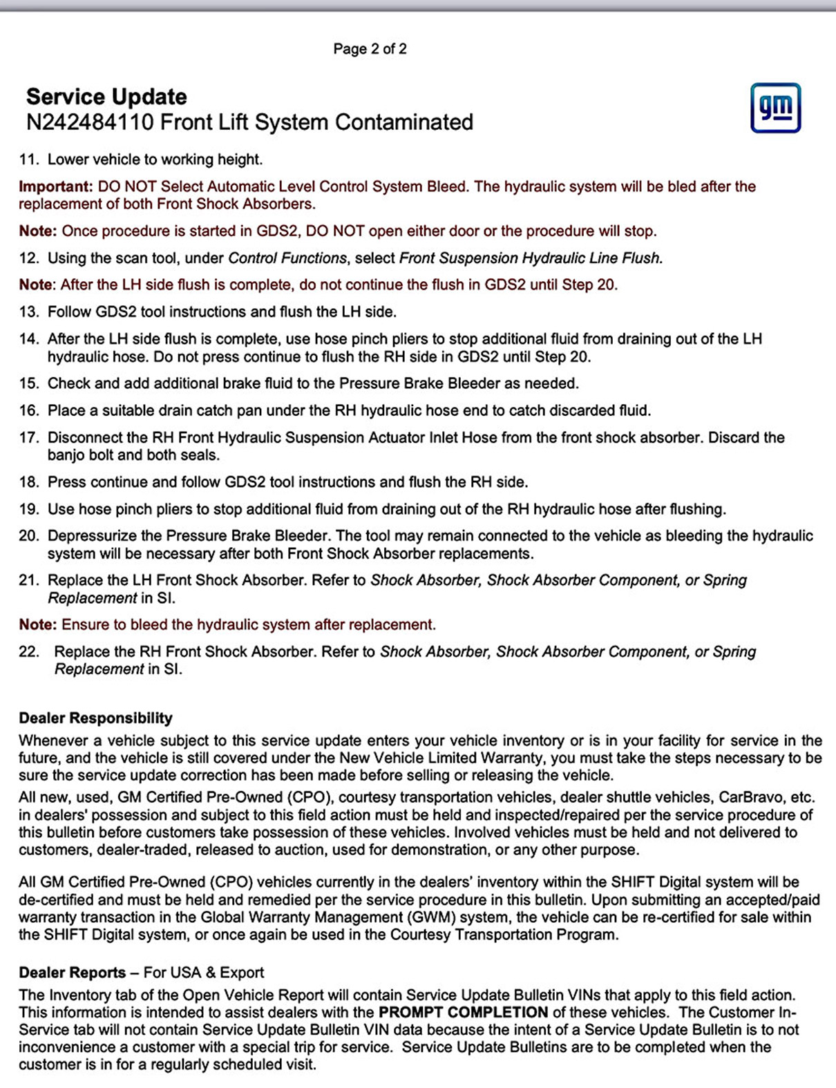

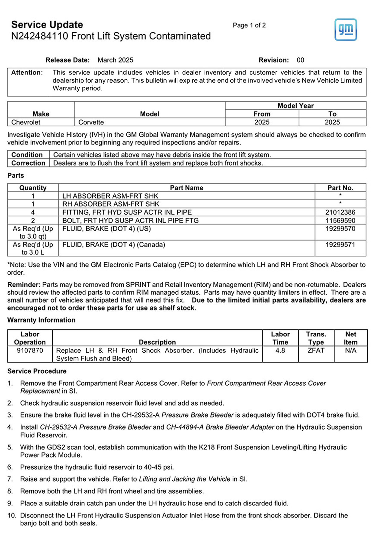

Chevy has just issued a new Technical Service Bulletin (#N242484110) for 2025 Corvettes over contamination in the Front Lift system. If your 2025 Corvette is experiencing front lift issues, it could be time for a visit to your local Chevrolet dealer’s service department.
GM says certain vehicles from 2025 may have debris inside the front lift system, and the corrective action by technicians is to flush the system and replace the two front shock absorbers.
The time for repair is nearly five hours for this fix.
