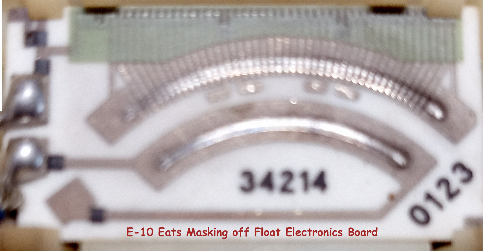

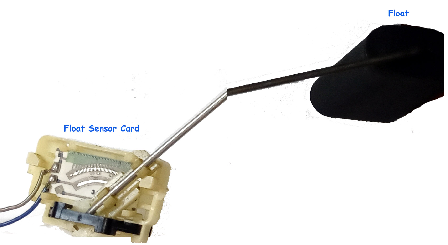

Damage to the float electronics card where the Ethanol eats away the masking on card
causing resistance changes that the float arm touches
