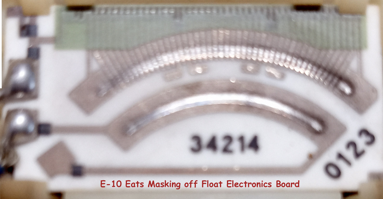

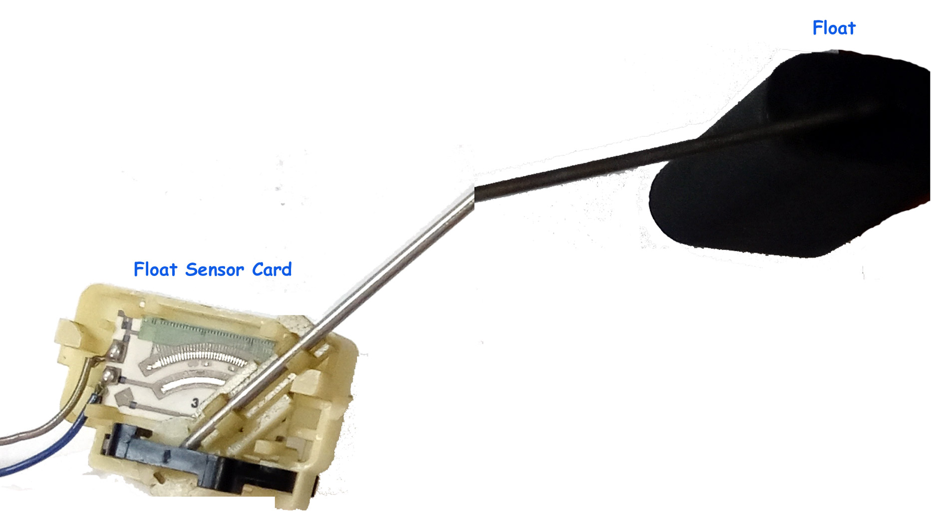

#6752 - 04/12/25 10:32 AM Re: Fuel Level Sending Units [Re: teamzr1]
More proof of damage to the float sender due to Ethanol eating mask off card
