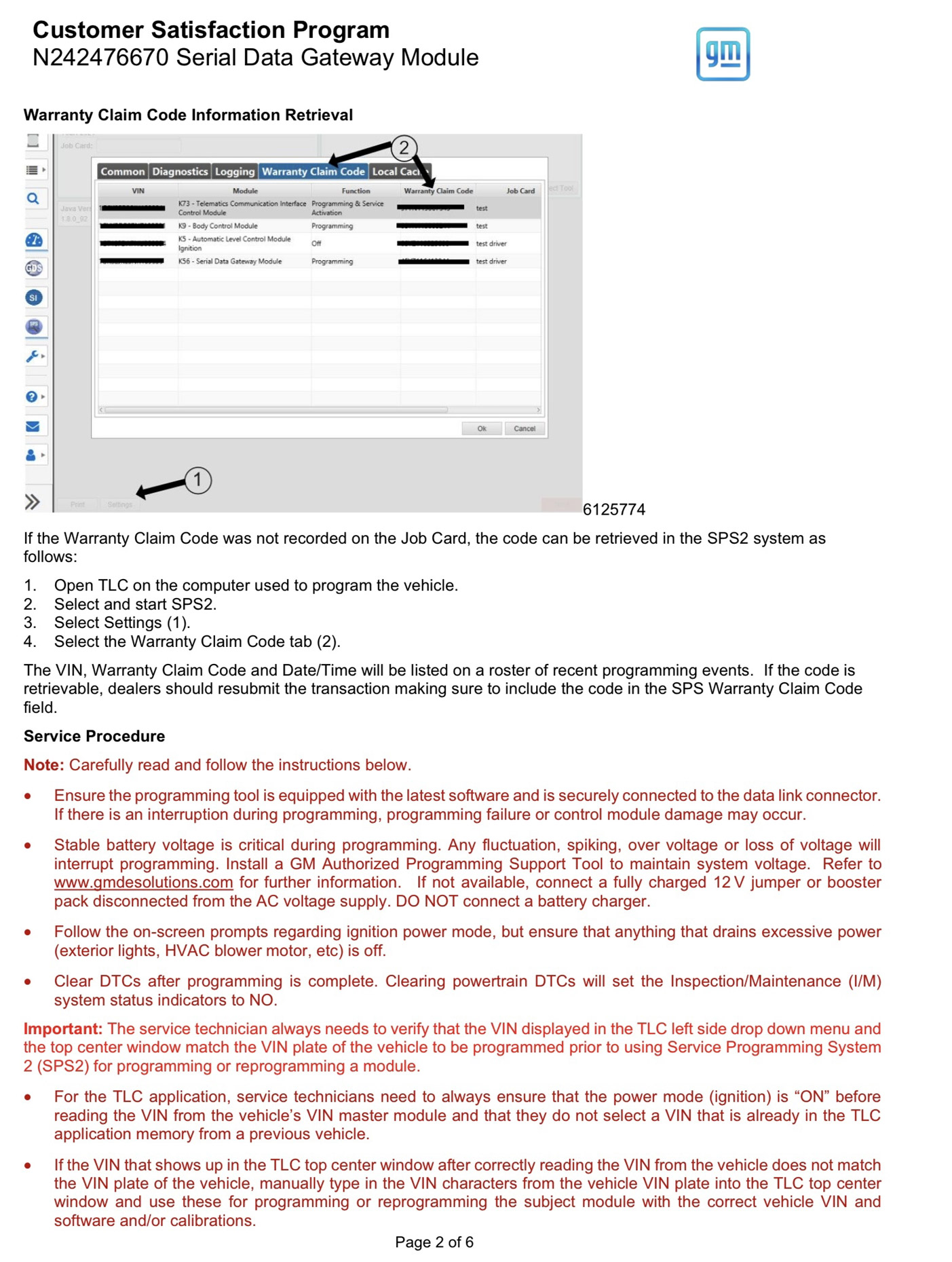

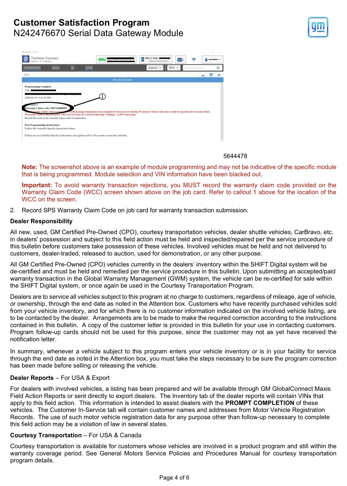

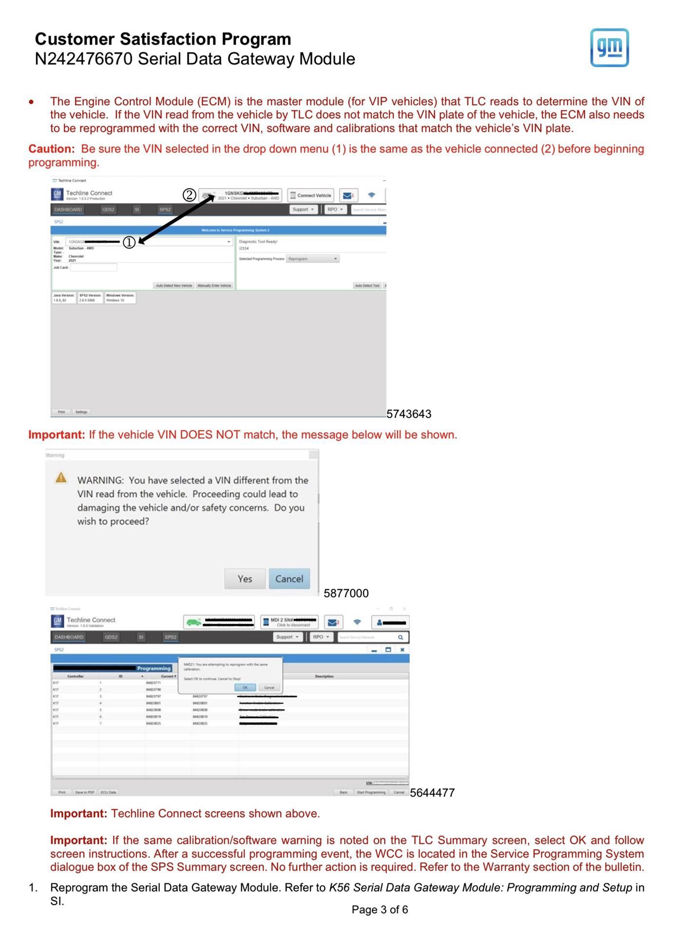

Battery Drain After a OTA 2024-25 MYs
Be aware of this serious problem after a OTA is done if the TSB update has not been done
