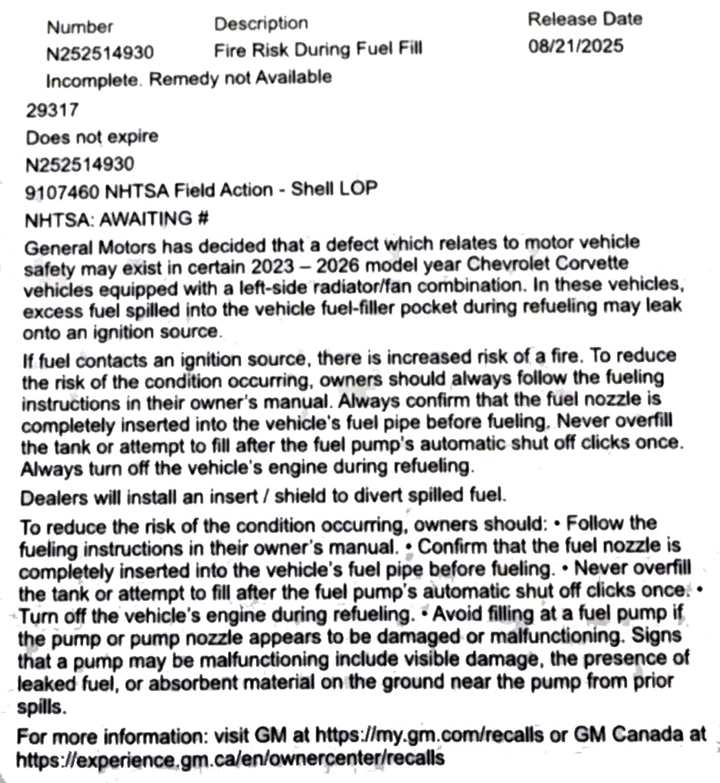

As for some background info, there is a document from the National Highway Traffic Safety Administration (posted below) that goes into more depth with the issue. Excess fuel that spills into the vehicle’s fuel-filler pocket has the potential to contact an ignition source, leading to an increase risk of fire. That NHTSA document says that dealers will install some sort of insert or shield to divert spilled fuel.
We spoke to a dealer about it tonight as one of his customer’s cars burned at a gas station. What he said is that the fans on the left side of the car will run even when the car is turned off, and if any gasoline that spills into the fuel-filler pocket and hits an ignition source like hot brake rotors, it can ignite the gasoline, leading to a car fire.
The Z06 & ZR1 are the only models currently being produced that have the left side radiator/fan set-up. They are on the ZR1X as well, but that car hasn’t entered production yet, which is why this Recall/Stop-Sale doesn’t impact it
We also saw that GM thinks that malfunctioning or damaged pumps could also be to blame for excess fuel spillage. The NHTSA says never to overfill the tank or attempt to add more fuel after the pump’s automatic shutoff clicks the first time.
