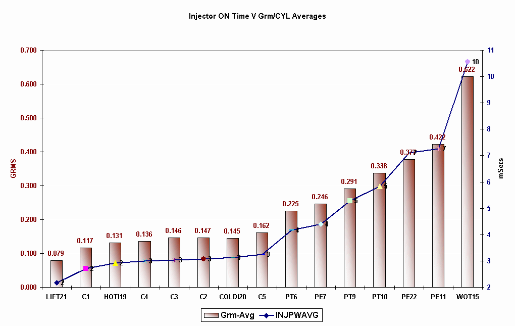

Not sure what your asking since as here is an example of a testrun and as engine load increases so does airmass which increases grams/cly to injector ON time
[Linked Image]
