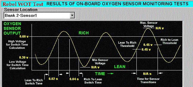

Here is a before PCM tuning and then after tuning to reduce knock counts and to increase timing for good WOT performance.
Before, see lousy low timing
Low Timing
Frame by Frame analyzing of O2 cycle
[Linked Image]
Reducing knock
[Linked Image]
Timing differences just going a few percent of A/F ratio
[Linked Image]
As you can see we went from a low average timing to lower amoount of knock and very good timing at WOT.
