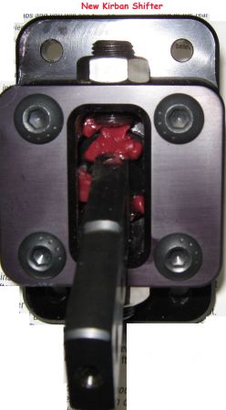

Installed the below Kirban Kwik® 6-Speed Shifter over fifteen years ago
Countless high RPM shifts on street and in racing

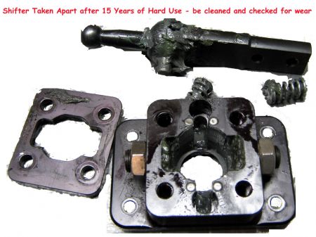

Wondered how it was doing and if any type of wear or degrading so swapped it with a new one ( vendor gave me for free ) so removed old unit to install the new one and took old one apart to closely look at the internals
After taking it apart and cleaning all grease out, closely checked each part to find almost no wear
Nicely made, billet and CNC machined and would clearly work as is for several more years so well worth the $220 I paid for it
