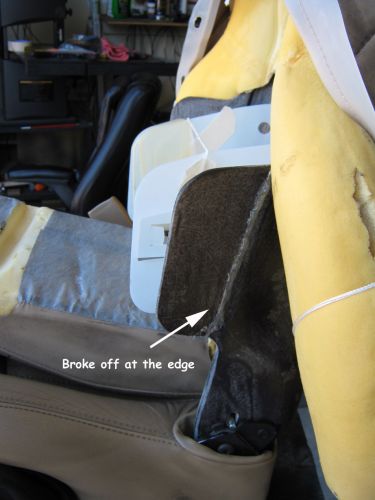

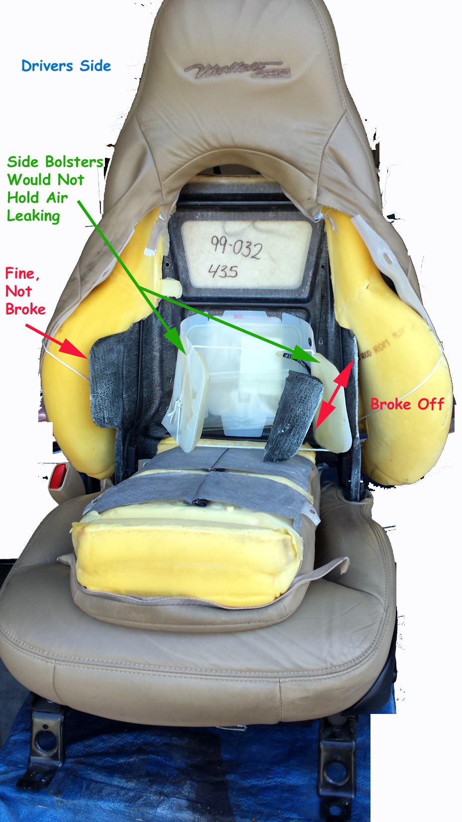

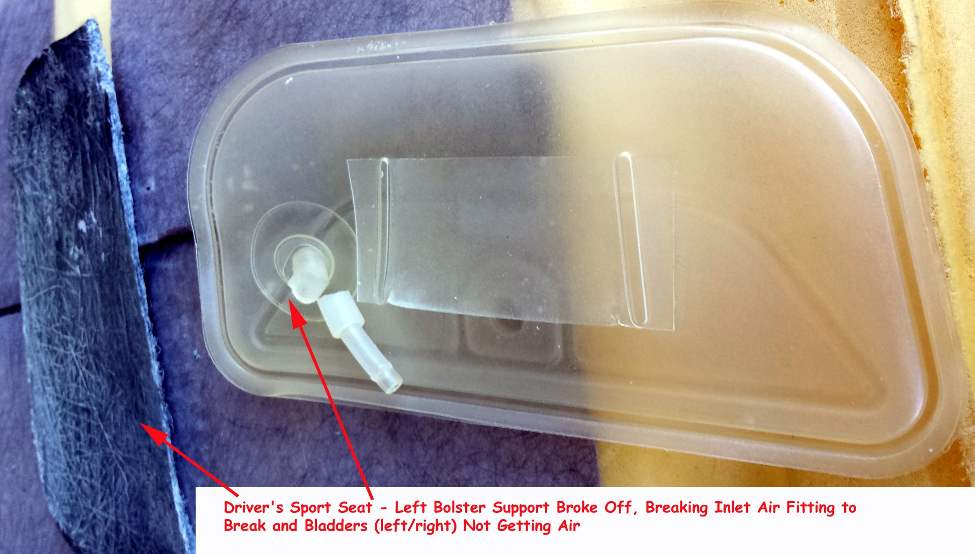

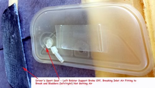

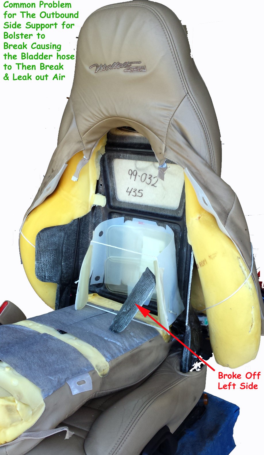

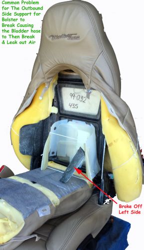

Common problem for the side bolsters quit working due to a air inlet fitting breaking, cheap plastic

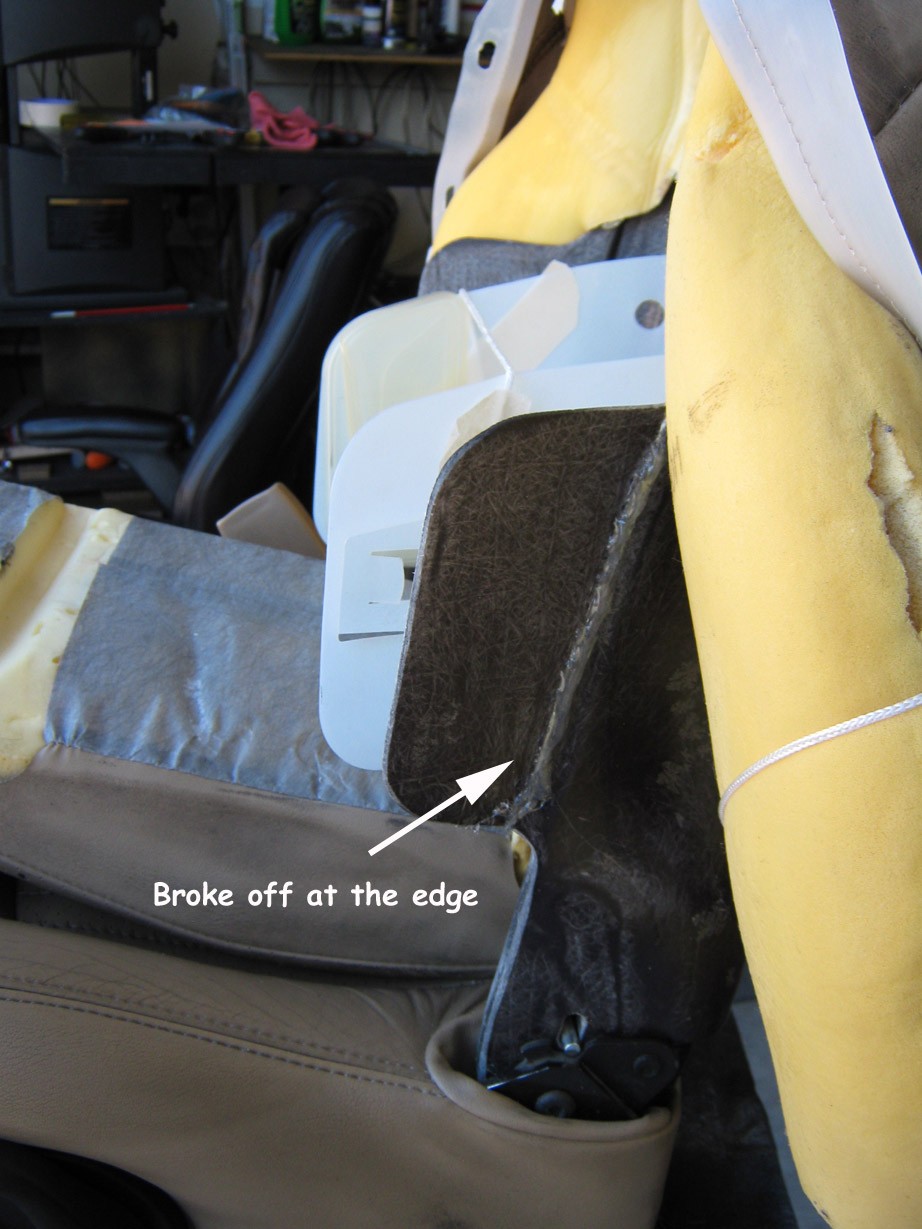

Also as shown the outbound side is prone for the fiberglass support on side of bladders to take body weight as getting in or out of car to break
Thus then the side bolster has no support and inlet air hose fitting breaks so now neither side bolster works as the use the same air hose supply from the pump
In my case 1999 C5 Coupe, Sports seats that allow adjusting the upper, lower lumbar and both side bolsters

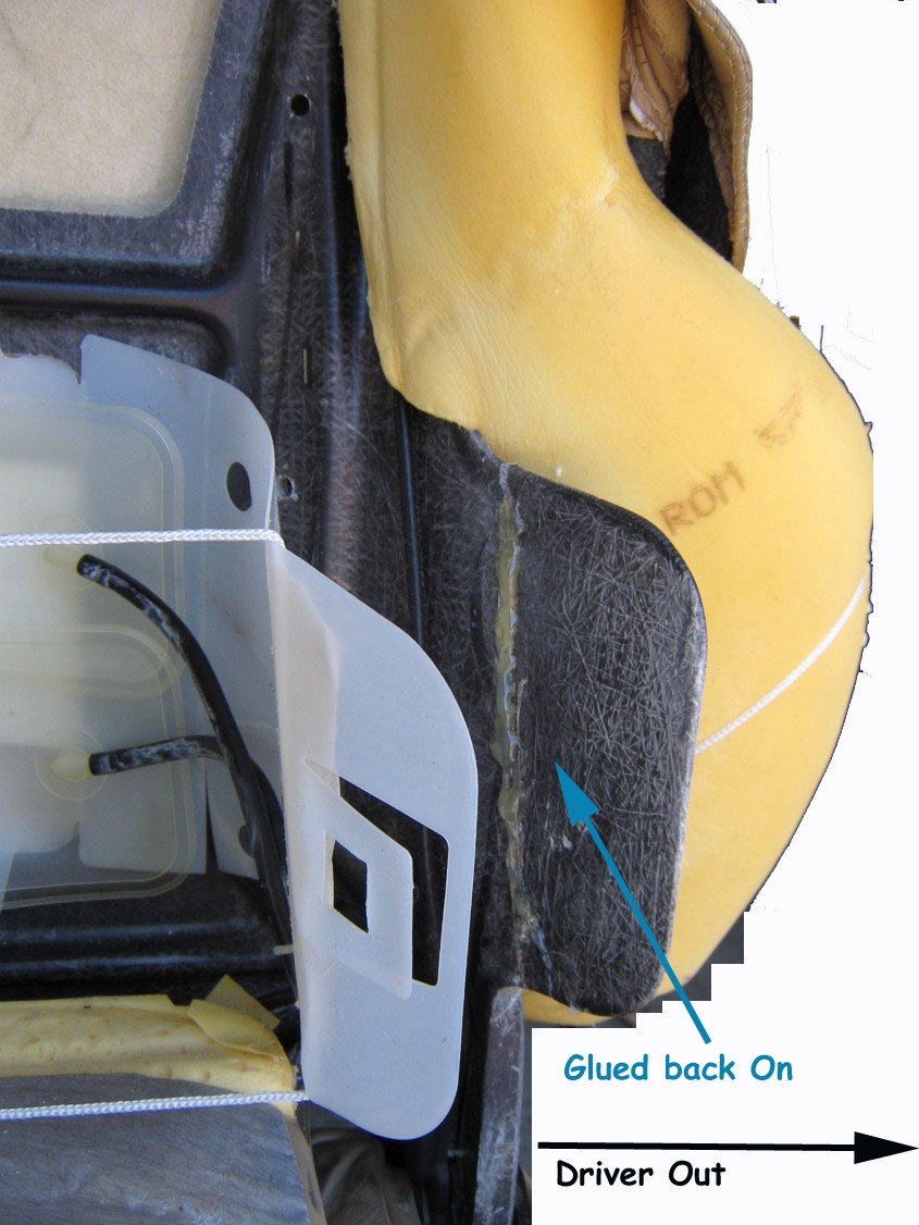

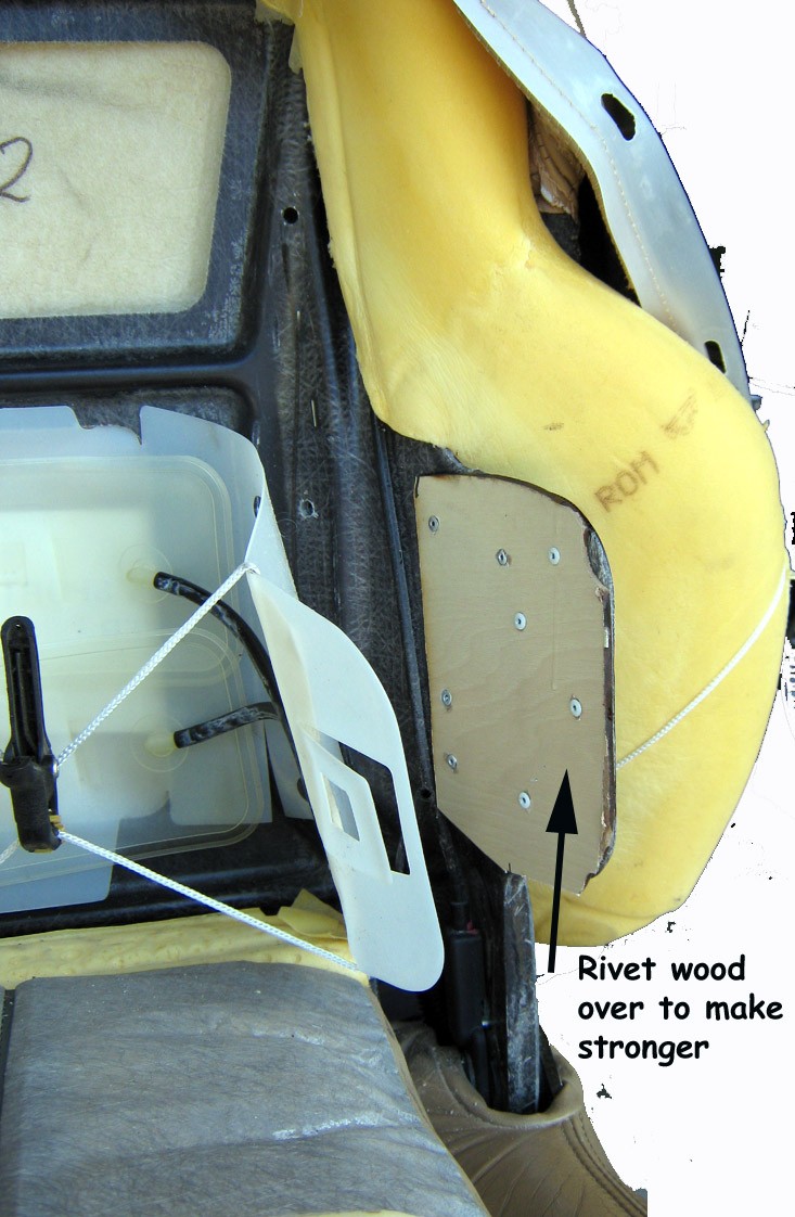

In this case trying to glue air fitting, repair side support, adding added strength of support with thin wood with rivets to bound to repaired side support

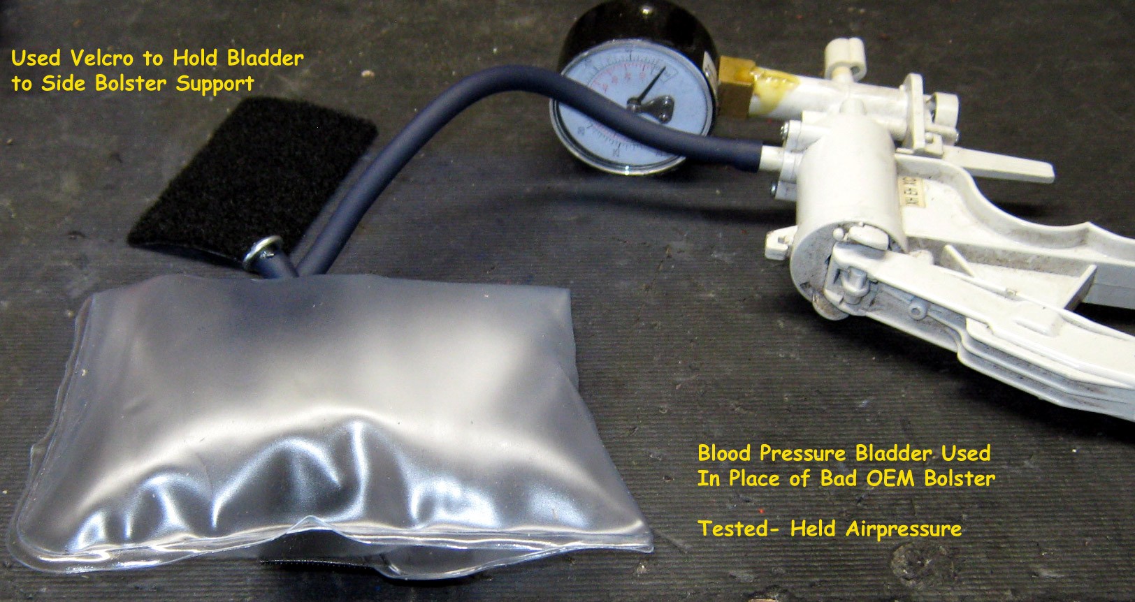

Replaced bladder with a bloodpressure cuff gotten from Walmart for $15. Stripped what I did not need and fitted bladder with Velcro to

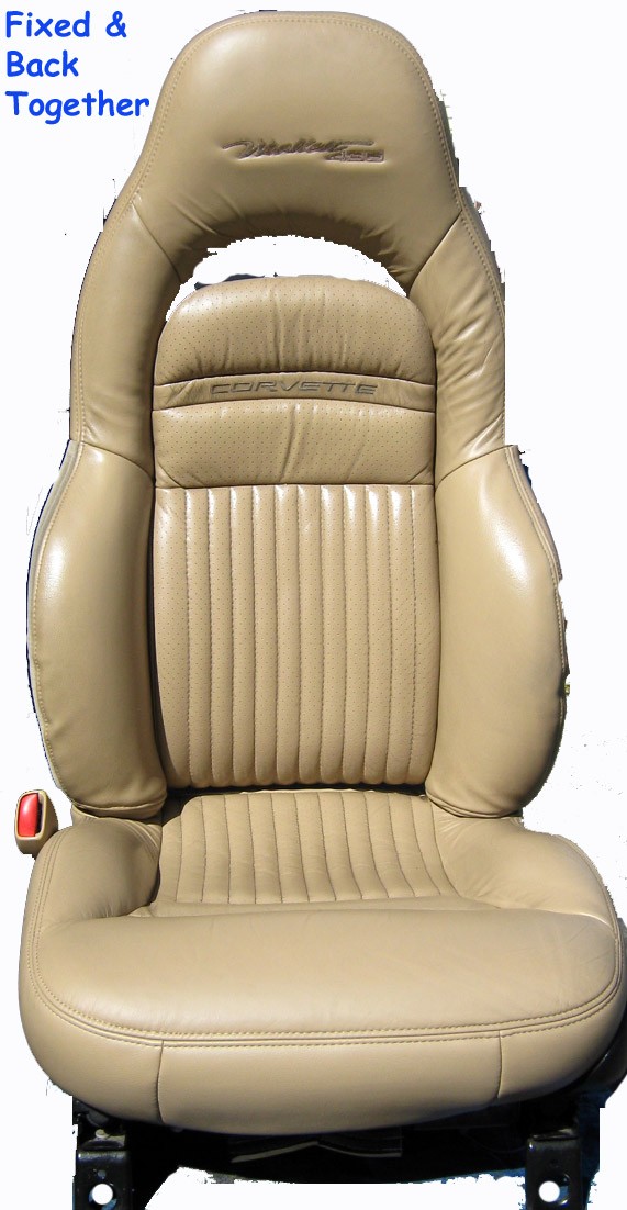

bolster side support. Works just fine that way

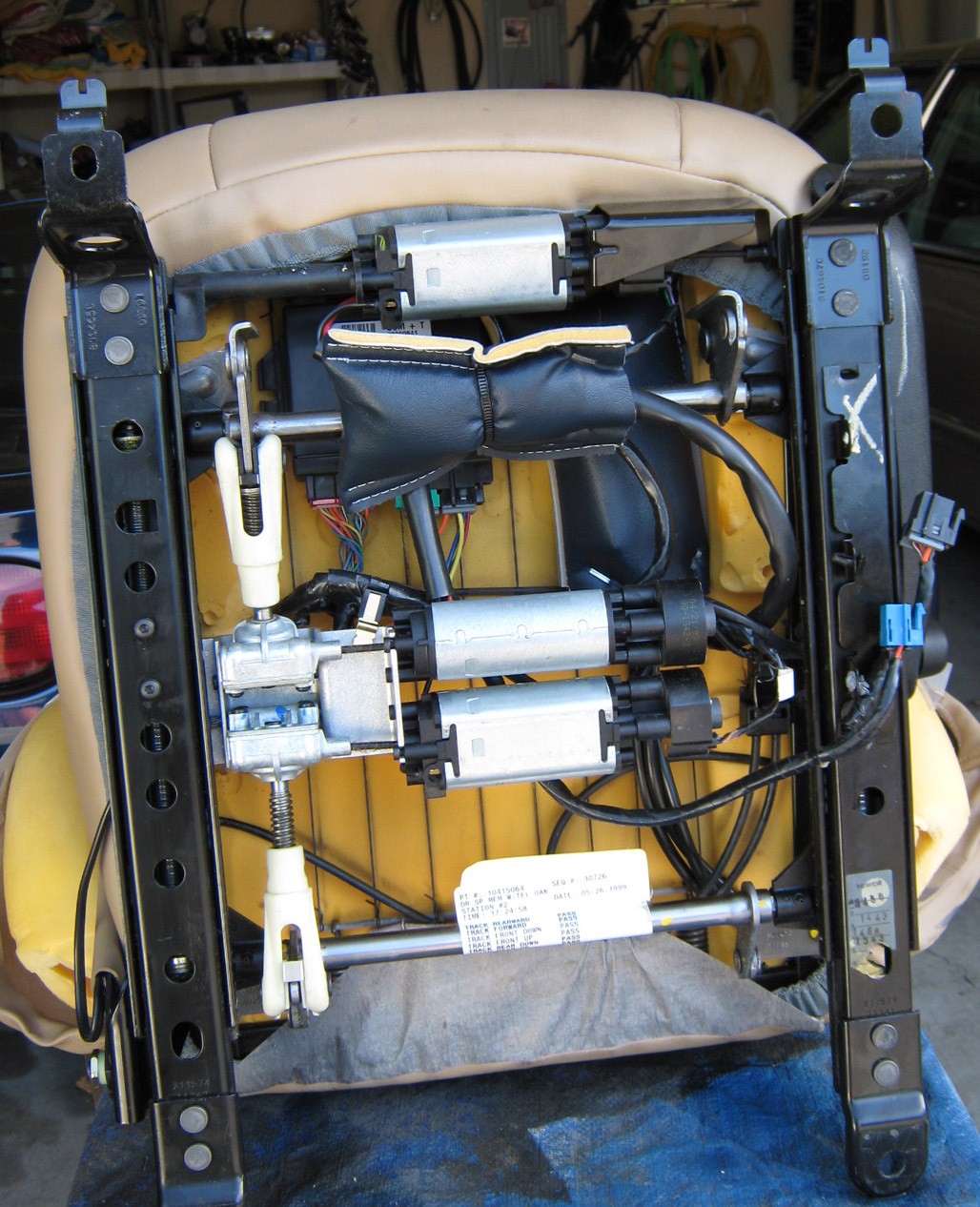

When removing seat take case taking off the 2 wiring connectors under the seat on outer side and then turn front of seat out the door
then take seat out. Reverse when installing back in
Take care in undoing the two zippers in the upper back of seat to get leather off and then the six push pins that hold center of back and the plastic sheet that
holds the four bladders ( upper/lower and side ones)
